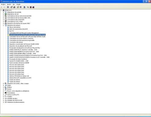

At the device manager appears one device "Microsoft Bus Driver UAA for High Definition Audio" that has an exclamation, but I didn't find how to fix it (the driver doesn't get updated itself).

And here are a screenshot with my device manager:
devices-jpg.31053

Hi,
judging from the dump file and the screenshot of Device manager your missing chipset drivers namely the chipset 'inf'.
Try this install...

Thanks a lot for your answer.
Here are the minidump files and also a screenshot of my device manager, one is having an exclamation but I don't know how to update the driver (I tried letting the system search itselfs and doesn't work).

Hi,
Try this install but if it doesn't work pop along to HP and find the support page for your machine as they'll have a version there:
Link Removed

Hi,
Link Removed
Thanks again for your help.
It seems I can't use the utility you told me because is for Windows 7/8. Instead of this and previously, I used a similar one (Link Removed) and It seems that updated some drivers, but didn't change the state of that device.
I don't know how to proceed.
