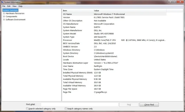

My win7-64 system crashes and reboots every few days, usually in the middle of the night. I have the system option to not to restart and the similar bios option set, but system reboots anyway. On restart, the familar Event 41 with bugcheck and powerbuttontimestamp set to 0. After manty hours of running standalong Dell diagnostics and memtest+, not hardware errors are reported. I've updated all drivers. Dell replaced memory, power suppy and video card. I'm running out of things to investigate. All help appreciated. msinfo32 screen shot attached.

You seem to have quite a few USB devices connected to the system, could you unplug any unnecessary ones?
