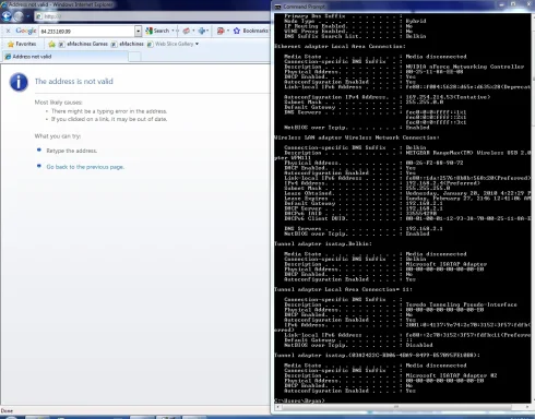

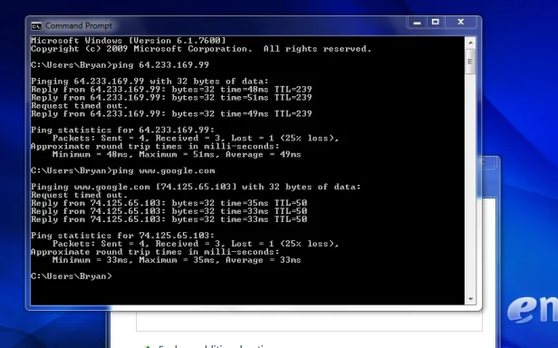

Not a problem. I see you are dropping some packets, which is not good. Open IE8 and type 64.233.169.99 into the address bar and hit enter. Let me know what happens. Also post another ipconfig /all for your wireless adapter.
Drew:
Yes, you are correct. The IP address of his router is 192.168.2.1 I suspect that it may be having a problem forwarding and properly resolving DNS queries so I suggested that he use the IP address of google in a web browser to see if that was in fact what is happening. He may ultimately have to resort to a firmware update on the router, which I believe he will have to do from within the router interface itself, since I couldn't find anything on Belkins site to download a firmware update, but there is an option within the router interface to search for a firmware upgrade.
i did type it up there. got same result. i actually just tried both since it didnt work. and posted wrong one

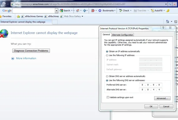

Please click start and type ncpa.cpl and hit enter. In the resultant window right click on the Local area connection and choose disable. Right click on wireless network connection and choose properties. Uncheck IPv6 and then select IPv4 and click the properties button on the resultant window near the bottom choose the button that says use the following DNS servers and in the preferred box type 8.8.8.8 and in the alternate box type 8.8.4.4 reboot and try again.
still no internet. did u want me to click the 'validate setting before exit" button first? and heres another pic of everything.6.PNG
No that shouldn't be necessary. I suppose we've come to the point where you may very well have to perform a firmware update on the router so...

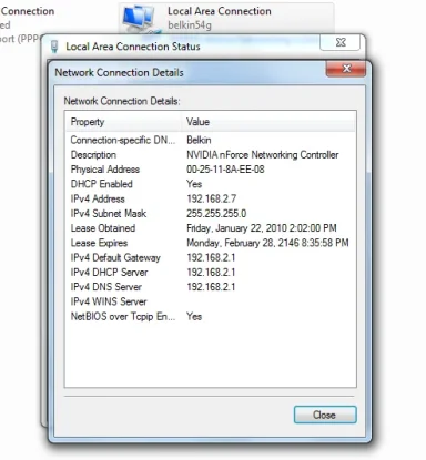

ok so i disbaled wireless and enabled local area connection. not sure what info u need other than the router information. i just have an ethernet cable running straight from the router to the back of my pc. and i disbaled ipv6. also dont remember how to set the ip to auto config.
-no security on it yet, just bought the pc this week, and havent had internet on it yet so saw no need to put any antivirus on it til i had access to the web. so w.e security comes with a desktop with windows 7.
