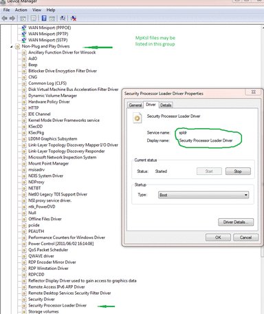

  16. Saltgrass
    Saltgrass Excellent Member
    Microsoft Community Contributor
    Joined:
    Oct 16, 2009
    Messages:
    15,157
    Likes Received:
    393
    The MpKsl devices/drivers may not be related to you main problem, it just looks a little strange. The drivers seem to be related to a Microsoft Security Essentials install (maybe a beta), but not sure. I have MSE installed but do not show any such files. If you search your system, you may find them. I have not checked your "Fix-it" reference, but I will do that now and post back if I find anything.
    Edit: I don't think I would run the fix-it either.
    I have attached a picture of the Device Manager when "View hidden devices" are allowed to show. The non-plug and play section is probably where the devices would show up. If your MpKsl drivers do show up, you may be able to get some information, or remove them. The SPLDR device shown is what you show as a problem device in safe mode. I can only guess, but maybe it is having a problem with the MpKsl files since it is a Microsoft certified driver.
    Edit:
    I just started my system in Safe Mode and get the same spldr problem device, so that does not seem to be relevant.
    Trouble will probably find out the real cause of your situation, when he gets enough info.
