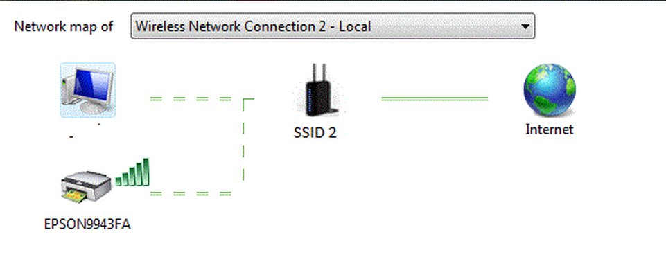

    Thank you. I will keep things as concise as possible ansd also answer the specific questions raised.
    Using the config utility to switch off first all start up items, then all services except Microsoft, then to switch off both of these categories at the same time, finally to switch off all SU items and to switch off all services including all MS services. Each time re-booting and trying for internet connectivity. Persists in having no internet. For the final scenario above it's not possible to generate a system info file as the required MS elements to produce it are not running. However it is poss to produce an .nfo file with all SU items and all non-MS services switched off. This is attached, called clearstart.nfo.
    I say that in "clearstart" there's no internet, but I do set my open windows to persist after a start and as I closed down whilst viewing the Network and Sharing Centre, this window was open to be seen as the machine re-booted. For about 2 seconds the internet was connected, the network was Home, named as 120120 and was working - I almost loaded an entire internet page. Then as always the network became unidentified public and failed.
    Oddly, the basic network information always showing that at the internet end of things the internet is there, it is the network that is unidentified and cannot make the internet available for use, yet the internet is known and seen, it is not, for example, a question mark, it is an internet world globe symbol.
    The connection to a working internet connection can be provoked in normal mode by disabling and re-enabling the wired network adaptor or by making changes to the adptor to stop and then re-start it. But it only lasts about 1 minute at most.
    I have noticed that during these brief connections and again here now, with a stable connection in Safe Mode, the network connections are 120120, which is not 120120o2, despite the machine being plugged into the 120120o2 router. The laptop, when placed here during the last post (or so) and working in normal mode, shows the connection as 120120o2.
    Here in Safe Mode whilst on the internet on the problem tower I cannot map the NIC or the W/L or the W/L connection 2, as the mapping wizard says the adaptor is not present or working. Drilling in via a different route, the Local Area Connection Status is all present and correct. Going further in, the Network connection details show the IP of the adaptor as 192.168.1.97 and the IP V.4 default gateway as 192.168.1.254 with both the DHCP and the DNS Servers on this same gateway address.
    Answering your questions: The ADSL v.2 router here is o2 ISP supplied and branded as o2 Wireless Box Version II which is seen elsewhere as a Thomson TG585 V.7. Upstairs it is a Netgear WPN824 V.2. There is no internet connection sharing via the OS and no protocols were known to have been used to facilitate anything. The Cable broadband no longer feeds the house, nor a phone line, nor TV, but even if it did, nothing is connected to any former Cable supply lead, so all Cable services are gone. This problem did not coincide with that removal of services. The network is fed from one router to the other by mains networking, also known as a Home Plug or a powerline adaptor, made by ComTrend. "Mains" is what I call the domestic electricity supply, i.e. what heats up the kettle or lights the home, for example.
    I don't know how much more info to give for fear of scrambling brains.. or eyes, yours or indeed mine!
    I have quickly popped back and done these tests and posted in order to see if things might move forward, I will be back able to check for any posts and then be back again in probably 3 - 5 days, earlier if at all possible. Apart from anything I am fortunate to receive from the Forum, I think my main shift is now away from how the PC starts. I cannot fathom what happens in clearstart and in normal but not in safe mode, to prevent internet or conversely what does not happen in Safe, but does happen in the others, to thwart internet. It is counter-intuitive. So, I am heading more towards how the PC mis-interprets the network. I will wait for a time when I can switch off the upstairs router and see if this machine properly nestles into the o2 router and 120120o2 network off its own bat. Separately I think I will also give the NIC the same specific IP address I have seen it adopt and hope it maintains that during a normal boot and remains connect to the internet, usably. I must admit there is a slight feeling of deja vu - did I try this 9 months ago when previously trying to fix it, it might be in an old post deeper inside this thread. Anyway, it is quick to do.
    Thx.

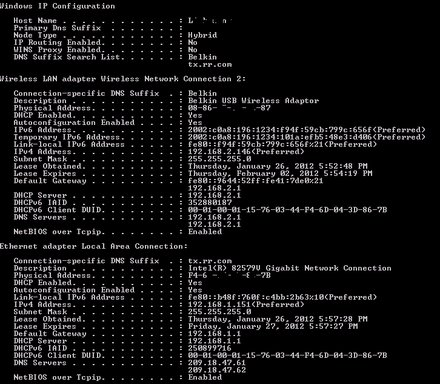

    As Saltgrass is suggesting, any steps you can take to simplify your network into a single collision domain may help resolve your issues or at a minimum help make diagnosing the issue easier.
    In the mean time can you provide IP addressing information regarding both condtions (safe mode with networking and normal boot)
    When the network is working perfectly in safe mode with networking, open a command prompt and type
    ipconfig /all > desktop\SafeIp.txt
    and when the problem is present under a normal boot type
    ipconfig /all > desktop\NormIp.txt
    This should produce two text files on your desktop named SafeIP.txt and NormIp.txt respectively. Zip them up and attach them to your next post.

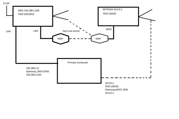

    I thought I would throw a little levity into the discussion by attaching a concept drawing. You should be able to amend it as you see fit and re-attach.
    You chose to do a LAN to WAN Cascade connection, so the routers had to be on separate networks. If you would have used a LAN to LAN, they could have been on the same network with different IP addresses and the DHCP server turned off on the second one. Probably the same SSID also.
    I realize you are using 4 network adapters of some sort to replace the 2 WAPs I show. This might be something you could pencil in.
    Perhaps, on the network adapter not showing a default Gateway, you could use the IPv4 properties on that adapter and add a default gateway using the Advanced button.
    Trouble, please correct whatever is incorrect....

    Am finally back and so, armed with the many suggestions from you on the Forum, I have today been able to determine much, but not to solve it:
    I first set Intel NIC IP4 properties to 192.168.1.222, mask 255.255.255.0 and Default Gateway to 192.168.1.254. Despite unticking check for validity, was unable to proceed w/o DNS and alternate DNS servers filled in, had no idea what figures to try. Remembered that when I was with ntl cable for broadband I used to see 194.168.4.100 and 194.168.8.100 as the dafault something and alternate something when setting up e-mail and or router by hand, so I used these and got no setting error, settings held. Internet again showed at the end of the basic network map, the connection was briefly Home 120120, but before an internet page could fully load the network became unidentified unknown. The internet still is seen as always at the end of the network drawing, but it is not connected.
    Stopping DHCP also requires (here) WebProxy be stopped and the address of PC becomes local 169.254.173. 39 wifi .31 lan. The basic network map no longer shows the disconnected Internet. Turned DHCP back on.
    Servicelayer was already off, turning it on does not help.
    atchksrv is not found (by eye or by Windows search from the Start menu)
    so these 3 were reverted to as were.
    Got an old Netgear DG834G V.5 out of an old bits box. Performed no check of existing log on credentials nor any set ups or connection to ADSL line. Obtained on the PC 192.168.0.2 with no default gateway, no internet obviously. Resumed the o2 (Thomson 585) router. [o2 e-mailed me yesterday to offer a free no strings N router for "loyalty" and will implement that AFTER this problem is resolved if received earlier.]
    Registry key referred to is present and Value=0.
    Performed ipconfig all in normal and safe and attaching those.

    Ok, just to make sure, you disabled the DHCP client on your computer by using the services.msc and stopping the service? I was thinking there was a possibility something was using it to change your settings. If stopping the service does not help after you disable and re-enable your Network Adapter, then restart the service.
    See the attachments, but have you gone into your Network Adapter properties, IPv4 properties and entered a Gateway address using the Advanced button. You can see from the attachment that it will be entered in a greyed out state but will stick. Make sure you OK your way back out or the setting will be lost. The second attachment shows how it should look with Obtain IP automatically and an entry in the Gateway box on the IP Settings Tab.
    If you need a DNS address, use 8.8.8.8 and 8.8.4.4 which seem to be the Google public addresses.
    While you are in the Advanced IPv4 settings dialog, is there any information being displayed in any of the windows (other than shown) on the IP settings or DNS or WINS tabs?
    And lastly, when you setup the DSL, did anyone add anything to your computer, such as software or some special utilities? If you cannot think of anything, did one of the Internet Service Providers set up a multi-provider system, and if so, could ask as to how to reconfigure your computer?
    From your drawing, I can see why you are a little reluctant to disconnect any part of the system. :eek: As far as the wireless repeater goes, I have not set one up but the video seems to explain it. I do think I would start small and keep very detailed steps taken so you can back out if necessary.
    Good Luck..

    Yes, certainly, I did all that I understood, but not with the odd refinement - you've mentioned the couple of further steps. So, have now repeated it, not only adding adding the intended default gateway but also finding it persisting in the advanced settings, instead of just checking it had persisted in the standard settings. Also I have now disabled and re-enabled the network card (previously I had re-started the whole PC).
    All of this however does not lead to persistent internet connectiovity. If I have also stopped the DHCP service via services, actioning these above default gateway settings actually re-enables DHCP, the internet works for about 5 secs, before the "network" changes from local 120120 to unidentified with no name and no connection. If I disable DHCP then the internet changes from a new description of "enabled" to the unidentified, the DHCP does not start and there is no even brief connection. So, no joy, yet.
    Unless I disable DHCP, the home and then the inidentified connection persistently do - in the basic network map - always show the word internet and the internet world globe at the end of the connection. Without DHCP these are not there. But it suggests to me that the PC is perfectly clear that despite having an unidentified unusable connection, it does know the internet is there, it sees enough to be aware of the presence of the internet.
    I will try extending my wi-fi into one coherent broadcast network. This will also presumably allow or require me to remove the name 120120 from anywhere else and call everything 120120o2. I bear in mind that 120120 is the pre-failure normal mode network name as well as the one working in safe mode), so this could upset the safe mode working...
    And, I will look at the start up items per sysinternals.

    Having studied the Netgear WPN824 documentation, this device can act as a range extender which seems to be also called a repeater, in wireless but not wired mode.
    So, I could remove my successful mains network to the Netgear (whilst retaining the mains network adaptors everywhere else). Then, after obtaining basic info from the TG585 (I do not know the w/l Ch number in particular, but I have its MAC address and obviously the SSID and password) I could then set up the Netgear to pick up and re-broadast the same SSID.
    However, everything already works happily both on the TG585 120120o2 wi-fi and on the Netgear 120120 wi-fi - I have just re-connected my iPhone to 120120 instead of the 120120o2 to be 100% sure at this precise moment. Other laptops and the TV's / internet music / Apple TV (another of the connected devices I left off the simple network sketch) all connect happily to either network. Even the problem PC connects wi-fi to either network, but it does not - unlike everything else - result in seeing the internet.
    So, I have decided not to use the WPN824 as an Extender, but rather to keep it as a source of the alternate wi-fi, at least for now, instead to focus on the problem PC.
    Using Sysinternals I have switched off a number of unused / unwanted items and re-booted. Unfortunately I am still not connecting to a visible internet, except in safe mode, on that machine.
